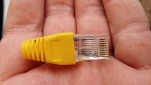

Morning Jacques. Get yourself a plug made (or make it yourself) like this. Just bridge the two outer points and plug it in the chatterbox instead of the pax headset.
