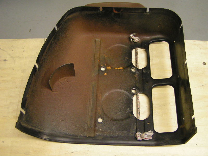

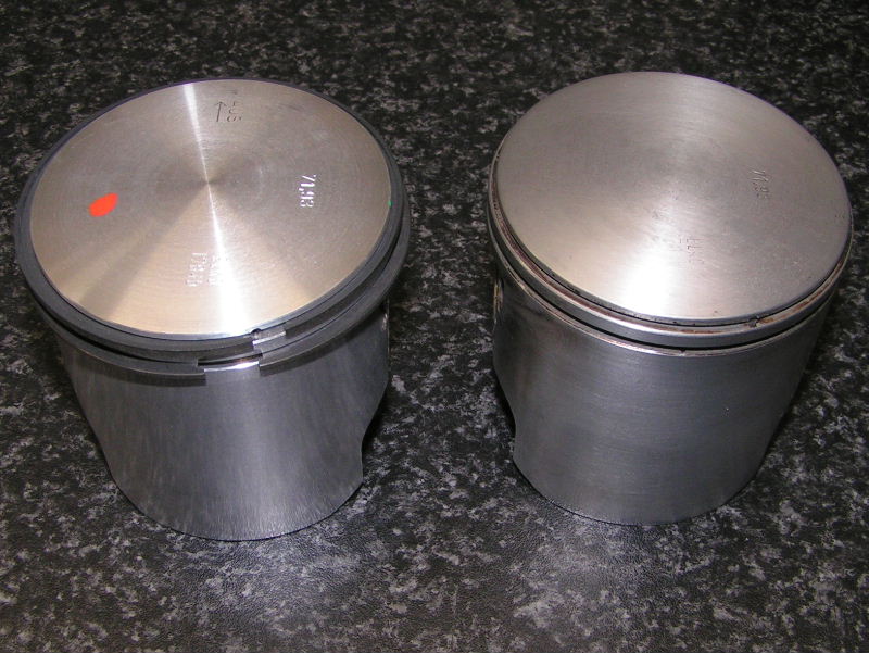

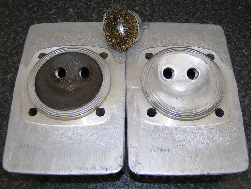

The next picture shows close-ups of the heads and piston tops. A fair amount of carbon formed burning a nice muddy brown. The camera flash makes it look lighter than it is. The experts tell me this is a sign of good burning motor, the jetting is just right.
Next I inspected the rings. Both the top rings were nice and loose, but both bottom rings was stuck on 50% of the diameter of the piston side.

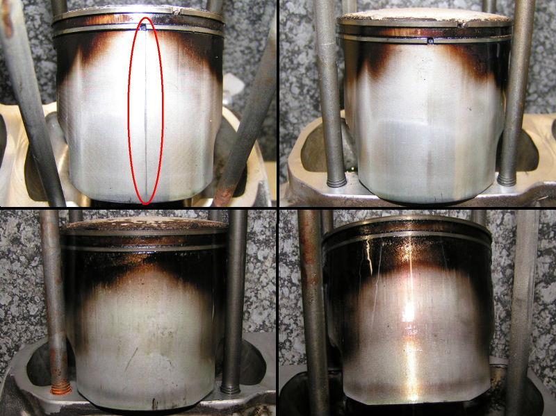

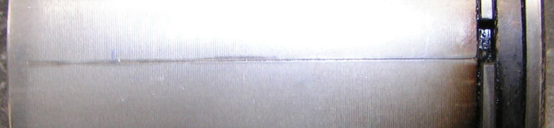

Then I noticed potential problem #1. The magneto side piston had a slight score line right down the centre in the middle of the intake manifold side. It is almost as if something very small went down the intake manifold and scored the side of the piston. It is just visible and one can hardly feel it, but it is there. I checked the cylinder walls and there is no scuffing. What ever small this was it did nut hurt the walls. Below is the intake manifold side view of pistons is on top with the corresponding exhaust side below.

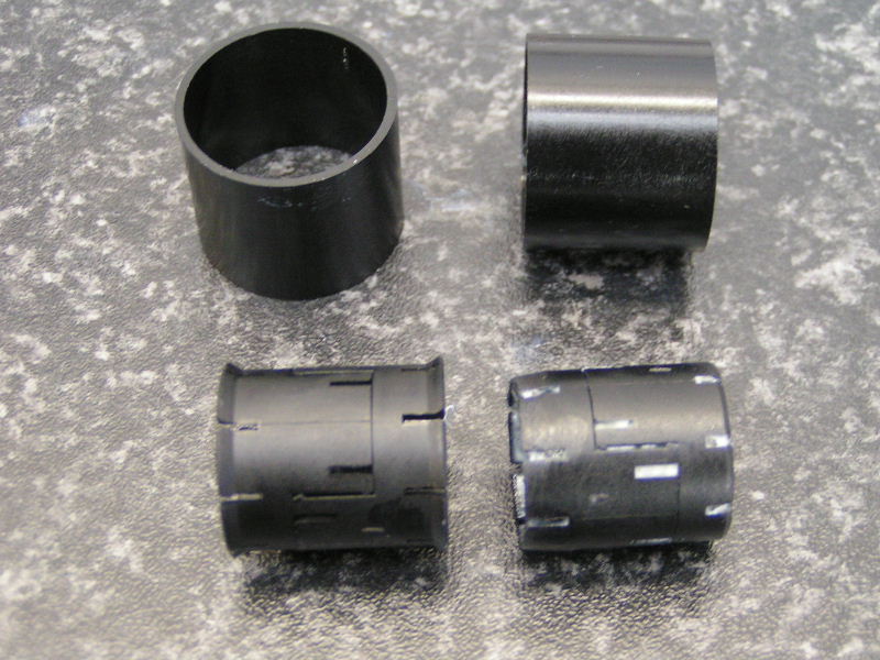

Next I turned the motor upside down and removed the circlips from the piston wrist pin. You can see where you insert a pick to remove the circlip shown on the table.

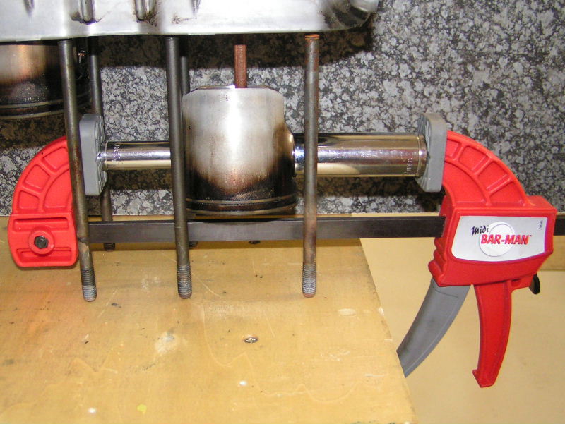

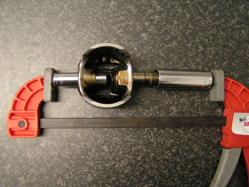

Next I pondered a while how to best remove the wrist pins, since I do not have a wrist pin puller…and then Eureka I got an idea that worked very well. I used 2 deep sockets and a big clamp. The small socket is smaller than the wrist pin and pushed it out into the bigger socket. I used 12mm and 19mm deep sockets and the wrist pin slid out without putting a lot of force on the clamp. Very easy, but pictures speak a thousand words. See below:

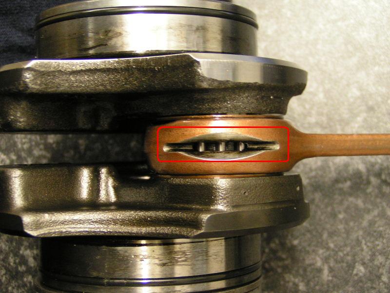

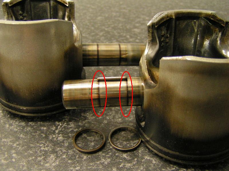

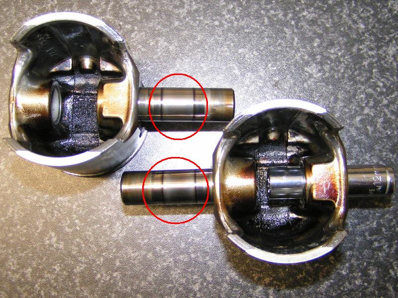

After removing all 31 needle pin bearings and the 2 rings I noticed problem #2 on the motor. Notice the 2 rings on the wrist pins. If you look at it closely you can see it is “blue-ingâ€Â, the ring is dark blue in colour which means the metal got hot and ‘burned’. It was evident on both wrist pins and occurred exactly where the needle pin bearings run as the pictures below depict. This means that some time during the motor’s life that the wrist pins did not get enough lubrication and hence the metal got hot and ‘burned’. Anybody got any ideas on why and when this happens???

After a bit of cleaning and showing the scratch on the piston to some experts it is clear that this scratch could actually be a crack and it is quite deep. That means this piston is kapoet, I will need to get a new one. The 2 expert guys I showed this to are still scratching their heads as to how this could have happened, since there is no evidence of any foreign objects. Hmmm good thing I decided to inspect my motor, who knows how long it would still have lasted…

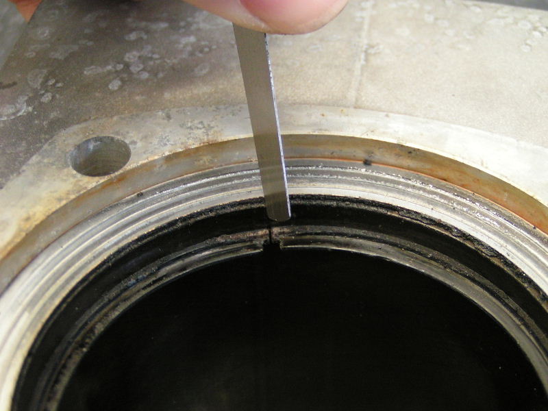

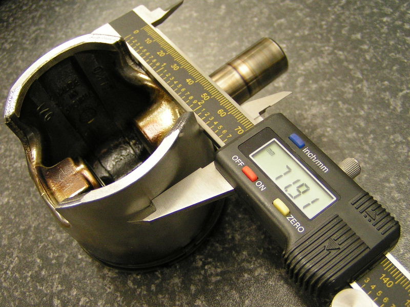

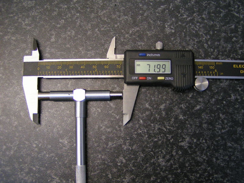

Any case I started to measure up the components to see how they compare to the Rotax wear limits. First the pistons, you measure 90 degrees to the wrist pin 18mm up from the bottom.

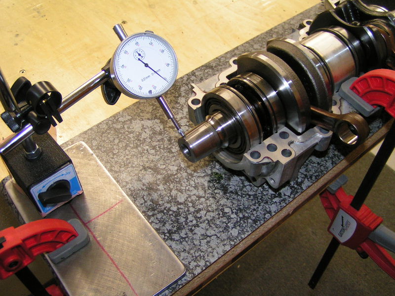

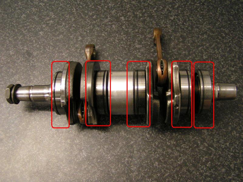

Next I split the crank case, and with the crank still in the lower halve check the crank for out of round with a dial gauge. Check both the PTO (Power Take On) Gearbox side and Mag Side it should be less than 0.03mm

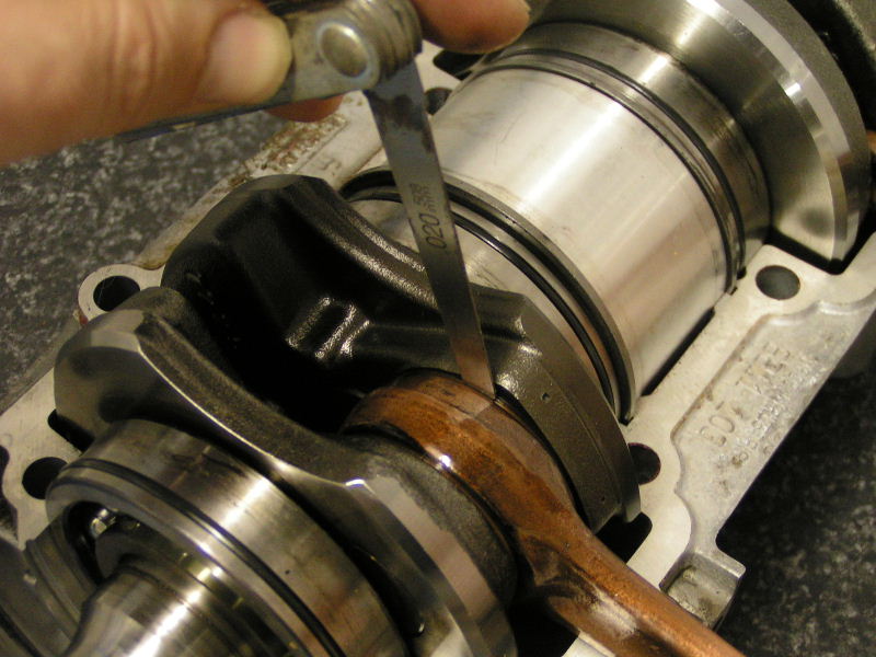

Next I checked the axial play, with a feeler gauge between the conrod and the trust bearing, it should be less than 1mm.

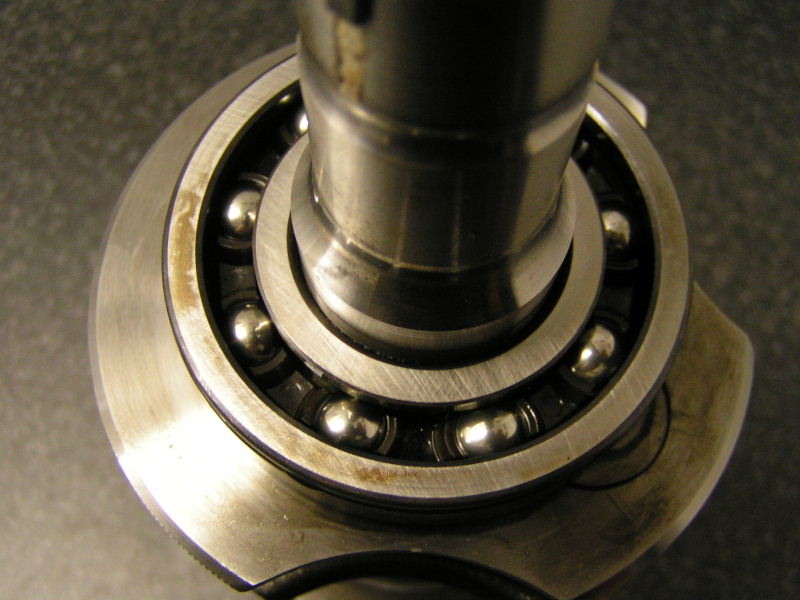

I took out the crank and inspected the 5 roller bearings. Firstly spinning them freely to see if I can detect any anomalies. Then I put some force on it with my hand and turning them through 360 degrees to see if I can detect any anomalies. Then you want to move them back and forth to see that they do not have excessive play on them, keeping in mind ball bearing do have some play.
Next I inspected each and every ‘ball’ in the ball bearing that you can see, to check for pitting. So far everyting is clear.
The last crank check is to rotate the conrod and inspect the rollers inside as best you can for pitting and or blue-ing.

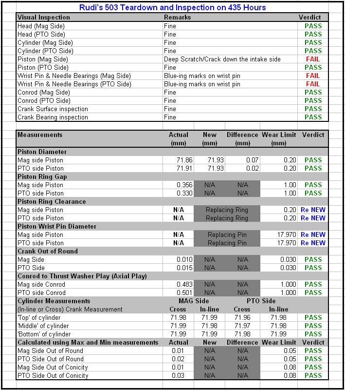

I started to measure everything up and made a table to compare to recommended wear limits. I will finish up the measurements and update the table in the next day or so.
Updated: I finished measuring everything

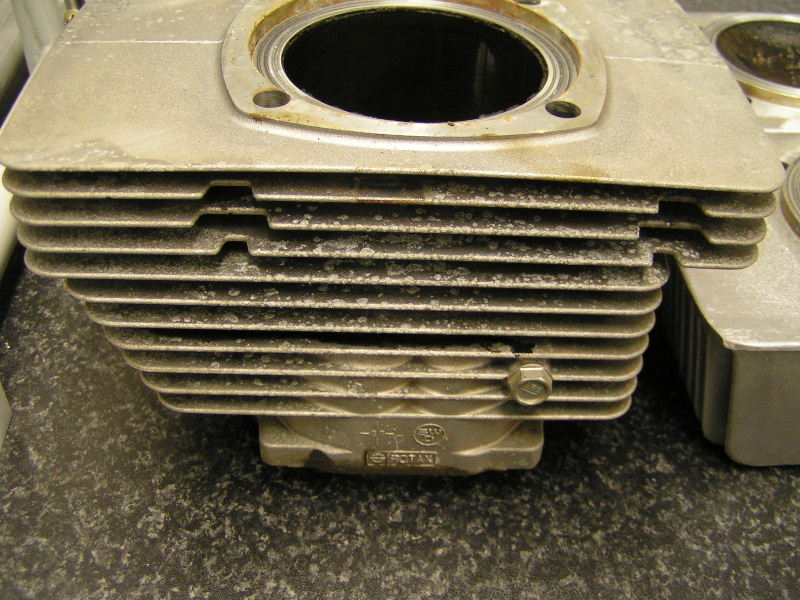

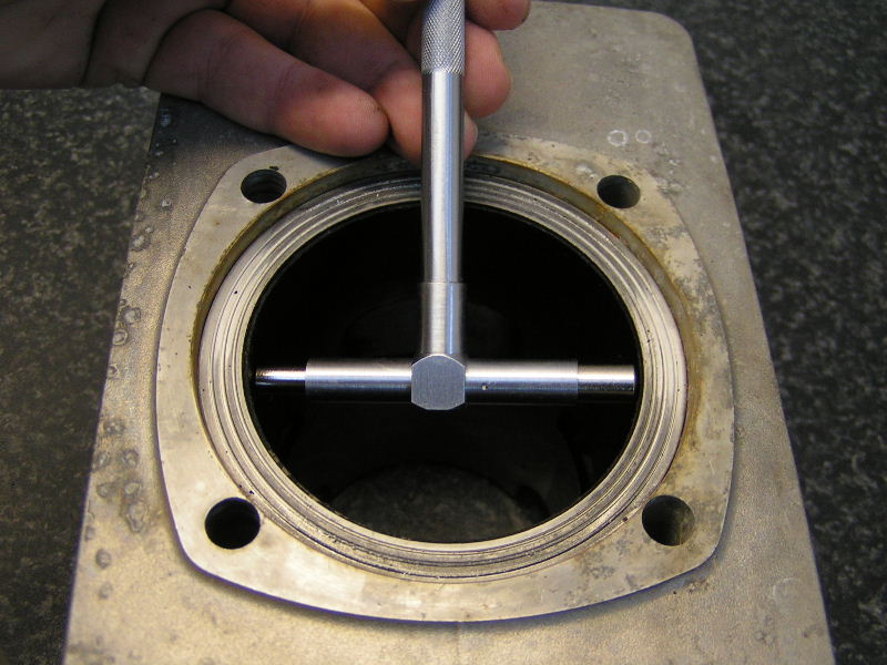

You have to measure the cylinders in 6 places to check out of round and conicity.
Measure the ring gap 5mm from the top.
Here is the table with measurements
The verdict: 1 new piston set, then new rings for the 2nd piston set, re-hone both cylinders, that will ensure the 2 pistons compression ratios are in sync. Though the experts say I can re-use the wrist pins with the blue burned marks on since they do not have any pitting on them I decided I will replace both wrist pins and all the needles, thrust washers and circlips.

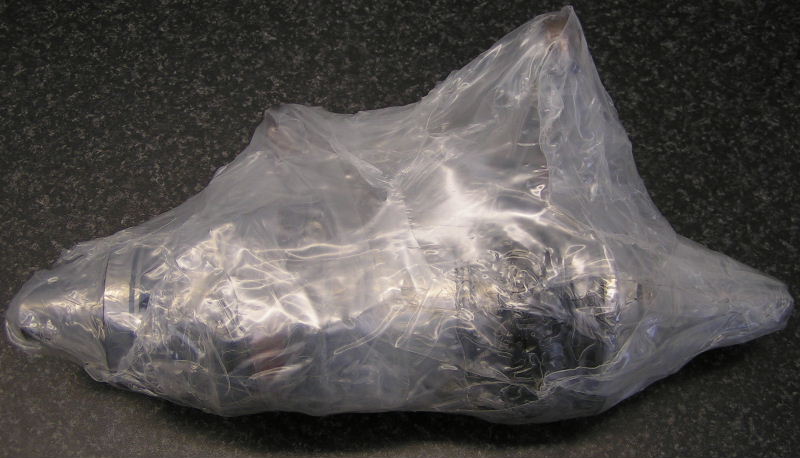

This moring I took the crank to a bearing inspection place in Jet-Park. They clean the crank and then spin up each rolller bearing and 'listen' / monitor each bearing for small deviations with sensative electronic equipment. They just phone me and told me all the bearings is fine, they should be able to last for the same amount of time (435Hours) at the same load and conditions.
They charged +/-R700, in my opinion it is good 'insurance' for a critical part of our little motors i.e. the crank which is also a very expensive component i.e. R5000+. Call it 14% 'insurance' levy vs new part to make sure it will last for another 435Hours.
If you guys are interested when I get the print outs and test results I'll see If I can load them up here. Let me know
Monday 5 June:
The crank back from its health inspection, nicely sealed.
The heads clean up nicely with the aid of a soft brass brush, just be carefull not the scratch the outer rings where the head seals! Do not use a metal or stainless wire brush it will scratch the Heads!
Spot the new piston The old one cleans up nicely with a lot of elbow grease and green scotch bright, just ensure you clean in the same direction as the oil groves on the side of the piston. I weighed both pistons and they are within 2 grams of each other, my scale is only accurate within 2 grams so they are OK!
The needle bearing come in a housing like this, I grinded of the shoulders on the inner ring on the right hand one. This then allows one to push it out the piston side during the installation of needle bearings and wrist pin.

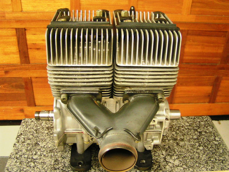

The 2 crank halves joined with gasket maker, and pistons back on

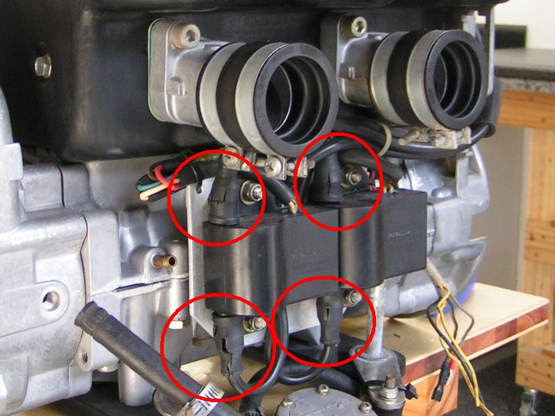

Put the cylinders on with gaskets and finger tight the heads, then use your exhaust manifold to allign the cylinders before torqueing the heads down.
The rest of the assembly is pretty straight forward. I decided to overhaul my fuel pump and carbs while I'm at it as well.

The black marks down the sides of the pistons is caused by blow by, i.e. the hot gasses leaking past the rings . This can be very easily seen from the exhaust port if you remove the manifold. This is a sure sign of stuck rings and necessitates decoking the motor.
When I stripped my 540 hour motor I had the same burn marks etc on the pistons and the crowns and heads were quite heavily coked. The wristpins did not have the blue burn marks on them so I believe your suspicions are correct wrt the engine over heating at some stage.
Be vary carefull when you remove the rings so as not to over stretch them. Once removed put them back into the barrel, use the piston to push them all the way to the top and then measure the gap. If it is under 1mm your rings should be fine.

Hi Morph,
thanks, the mark I was referring to is marked with RED eclipse in one of the pictures, top Left side view of the piston. It is not the typical Carbon marks. It is definitely some scuffing, very faint, but it is there.
Ja I know, I still need to measure everything, including ring gap, it needs to be less than 1mm. When I get a chance this week I’ll measure everything up and report back in PART 2.
Kind Regards
Rudi

Yeah I saw that. Whatever went down the side had to have come past the top ring first and how is not obvious. Is it not possible that a piece of carbon came loose from area in the gap on the second ring or whoever decoked the motor previously left a bit of dirt at that joint. Alternatively dirt came in via the intake manifold. I suppose it could have been anything, sand particle ?
The point I was making about the blow by was for others benefit, since the pics clearly show it. If you get blow by then your rings are stuck or worn.

On the tools: So far the only special tools required was the flywheel puller and gearbox gear puller. When the engine was ready with the pull rope cover removed and the gearbox rear cover removed I took it to my friendly rotax engine repair shop. They have the tools and it will take them 2 minutes to remove these for you if the covers are removed.
If you re-assemble the pistons you will need a small tool to place and space the needle bearings. I don't have one, so I will need to borrow one somewhere or make another plan when I get there, but I will post pictures. Anyone got any good alternative 'BOERE' ideas how to space the needle bearings on re-assembly please post below.

Rudi,greylingr wrote:Anyone got any good alternative 'BOERE' ideas how to space the needle bearings on re-assembly please post below.
we used lekker dik grease, coated the wristpin, stuck the needle bearings on to them, then inserted the whole lot into the conrod. Slowly pull the wristpin out and the needle bearings will stay in place. Place the piston over the conrod and carefully line up the wristpin. Push it carefully through. Remmember there must be 31 needle bearings.
If you make an insert the same diameter as the wristpin you will have to remove the circlips on both side of the piston so you can push the insert out the one side when you insert the wristpin from the other side
