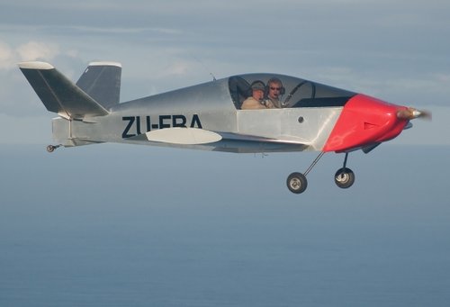

Does anyone know where to get tinted lexan or good quality perspex for a canopy/ windshield for a waaiex?

Unfortunately not the same as the Lexan which was supplied with Sonex kit. Looking through the polycarbonate things are distorted and difficult to see clearly. Does anyone know of better quality lexan available. Need a sheet of around 1.5 m x 1 m.?

What does it look like if you look through it at an angle - the nexal? The perspex has waves where its been rolled and distorts the view badly. The Waaiex which is Larry's plane has a vne of 200 mph which it easily gets to and the current lexan windshield is just over 3 mm thickness. It needs something to keep the wind out as I think if the windshield gave in it would blow the canopy off and the plane could possibly become unstable not to mention the wind in your face

Yes it's formed out of a flat sheet. Are there thicker sheets available such as 3 mm? If you have a chance over the weekend please have a look through it at a very flat angle if possible and see if there is any distortion.

If you had to sit in a Waiex you will see that you have to peer over the dashboard and not being able to see the runway in a taildragger at high speed is very disconcerting. You will K K yourself! The angle of the windscreen is very shallow as you can just peer over the dashboard when landing.
