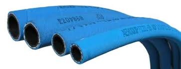

Try Aeroquip blue oil hose available at some hydraulic shops, I use it on the return line for the turbo on my KR2. I paid R275 per meter as its imported from the USA.
- image.jpg (11.66 KiB) Viewed 1204 times
