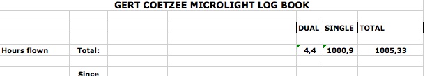

On Monday I flew my 1000th hour with my friend Steffen. As I was approaching the 1000th hour, I decided that once I've reached that milestone, I am going to upgrade. During the first week of January I am doing my conversion for the upgrade, with the Zee currently reaching completion.
